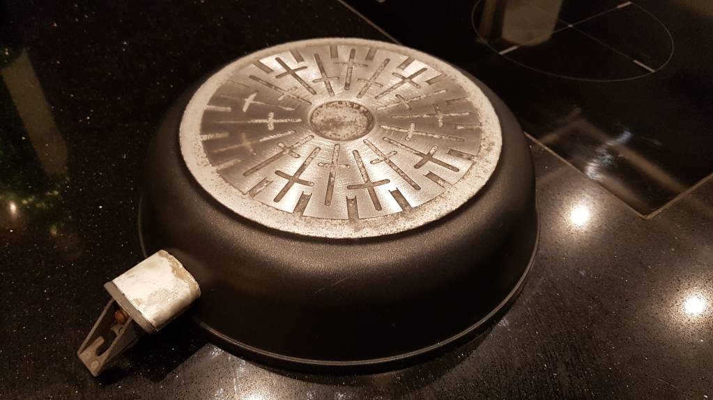

Let’s kick the "dog" out of the house!
Background.
In December 2016 we are moving to a new apartment. New renovation, large kitchen (combined with a room), new dishwasher, supply and exhaust ventilation, etc. In the first week we lived without a stove (hob), because the “kitchen workers” did not have time to make a countertop, and therefore they cooked in the oven. Dirty dishes were washed in the PMM. There was a lot of new equipment and instructions for them were read as free time appeared. After a few days of using the PMM, according to the instructions, salt was added and rinse aid was added. Two weeks after installing the cooktop, I decided to roast pork. 20 minutes after cooking, a very strong smell (of wet dog) appeared in the kitchen. The smell spread throughout the apartment. The countertop near the stove, the floor tiles, and the curtains smelled. The smell went away only in the morning. The same thing happened the day after frying the chicken. Moreover, there was no smell when preparing soup or cooking any food in the oven. We began to notice that the dishes made from PMM smelled a little like dog. After a month, the PMM began to seriously stink, and the dishes from it seriously stank of dog. I washed the PMM with a proprietary cleaning product - it helped for 2 days. I tried to change the products - it didn’t help (now I have a year’s supply of detergent
I tried the traditional method: soda + vinegar + hydrogen peroxide, the stench from the PPM went away, but the PSINA remained.
I could still put up with the dog smell from the dishes, however, believe me, it was unrealistic to endure the same smell (but tens of times stronger) that appeared every time I fry it! Because of this, they almost completely abandoned fried foods. Perhaps this smell was intensified by the supply ventilation, which constantly, in large quantities, supplies fresh air into the apartment. They just wrote here that the smell appears or intensifies when fresh air enters.
Is it worth describing all the experiments I conducted over six months, I think not. I will describe only those actions that helped me personally completely get rid of this smell.
1I washed the PMM with a folk remedy;
2 I reduced the amount of salt supplied, according to the hardness of the water supplied to the PMM;
3 Replaced the 3-in-1 tablets with Somat standard powder;
4 Refused to wash any utensils containing aluminum alloy in the PMM;
After these actions, the smell disappeared completely! No dog, no stink! There is no smell when frying meat products! Dishes, floor tiles, countertops (agglomerate), curtains, kitchen facades (glass), everything that stank before does not smell at all!
Aluminum alloy in PMM rather This is what causes this smell. It (alloy) in dishes can be different, and perhaps some component enters into a chemical reaction during washing. The appearance of a smell on interior items is simply some kind of mysticism, which I cannot explain. Further correspondence with the manufacturer of the frying pan, which, in my opinion, is the source of this problem -
I have Neva metal frying pans, in which the bottom and handle mount are made of aluminum alloy - This is what the manufacturer writes in the questions -answers:
Can products from the NEVA METAL TABLEWARE factory be washed in the dishwasher?
Yes. But we strongly recommend using detergents with a pH level close to neutral (in the range of 6-8), or specially recommended for washing aluminum products (for example, Chrystal Charmy gel from Lion). Otherwise, a dirty gray coating may form in areas without coating (the machined bottom, the place where the handle is attached).
After 7 days of using the aluminum-free (and odorless) PMM, I decided to conduct an experiment and washed the frying pan along with the dishes. The dog smell is back! The dishes taken out of the PMM had an odor. But the most surprising thing was discovered next.....
The dishes, which had been washed last time and had no smell, were put on the table near the dishwasher, and after a while they smelled like dog! After washing the dishes again in PMM, without the frying pan, the smell did not go away! I had to wash the PMM again with a folk remedy.
The conclusion I made: after washing the frying pan, the smell appears not only on all the dishes that were with the frying pan in the PMM, but also on all objects located near the PMM, such as: dishes, countertops, ceramics, porcelain stoneware, etc. And as my experience has shown, it is not enough to simply remove the frying pan and carry out another cycle of washing the PMM; unfortunately, you have to rinse it again with PMM, and do not put dishes containing exposed aluminum there.
For six months, I washed the PMM with a branded cleaner Finish more than 10 times, but I liked the folk method better.
For the folk remedy you will need half a pack of soda, 0.5 liters of vinegar, hydrogen peroxide and essential oil.
250 grams of soda mixed with 20 milliliters of hydrogen peroxide + 5-7 drops of essential oil (I used eucalyptus), roll into 4 balls and place on the bottom of the PPM in each corner. Turn on a full cycle of 70 degrees (without pre-washing) in the middle of the cycle, open the PPM and place a deep plate on the bottom of the basket and pour 0.5 liters of 9% vinegar into it. Wait for the cycle to complete, wipe the perimeter of the door with a wet rag to remove soda deposits, take out the plate and run it again on a short cycle.
Good luck to everyone, and enjoy the smell!

After much experimentation, I can confirm that the smell disappeared after we stopped washing dishes made of aluminum alloys in the machine.
The smell did not disappear immediately, but after 5-6 washes and a single use of the machine cleaner.
So I recommend everyone to stop washing aluminum pans and pots.
