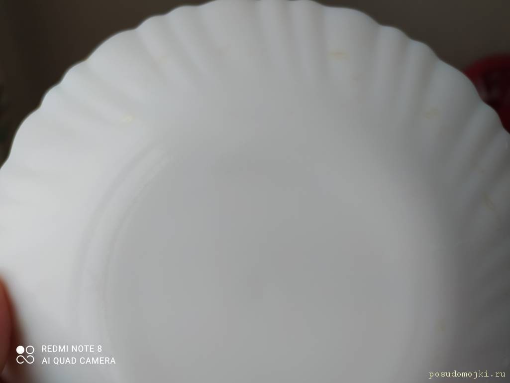

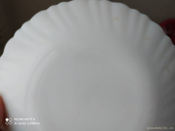

Good afternoon. Tell me, please, what causes such stains on the dishes? Only on the reverse side are small yellow spots, similar to coffee beans. Or as if drawn with a pen. I changed pills - it didn’t help.

I removed the rinse aid, poured it until it was full - to no avail(((terribly annoying(((could this be because of the water?

Yes, maybe. But where, because of the water? So what should I do, install an additional filter?

There can be many reasons, carefully inspect the PMM, perhaps you have traces of corrosion on some part inside the PMM, is the drain filter clean? Look for rust spots or accumulation of grease and dirt on the internal elements of the PMM
