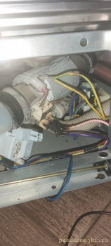

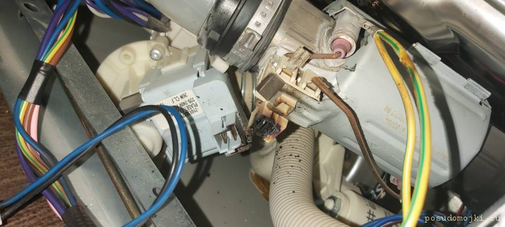

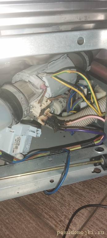

When the machine was working, periodically there was a smell of burnt wiring, I checked and found no reason. One fine day, there was a bang, smoke, and the machine was knocked out. When disassembling it, it turned out that the contact group feeding the heating element had completely melted. Help me find the reason.
At the same time, after the cotton and smoke, I turned the PM back on to the rinsing mode and it works, but I didn’t turn it on in the washing mode, I’m afraid.
When the machine was working, periodically there was a smell of burnt wiring, I checked and found no reason. One fine day, there was a bang, smoke, and the machine was knocked out. When disassembling it, it turned out that the contact group feeding the heating element had completely melted. Help me find the reason. At the same time, after the cotton and smoke, I turned the PM back on to the rinsing mode and it works, but I didn’t turn it on in the washing mode, I’m afraid.
Model Electrolux ESL95201LO.
I stopped heating the water, the technician called (this is happening in the village with my parents, so there is not a great choice of technicians) said that the heating element had flown, but it’s difficult with them now.
I can’t do it anywhere. find information about the heating element in this model.
Thank you.
