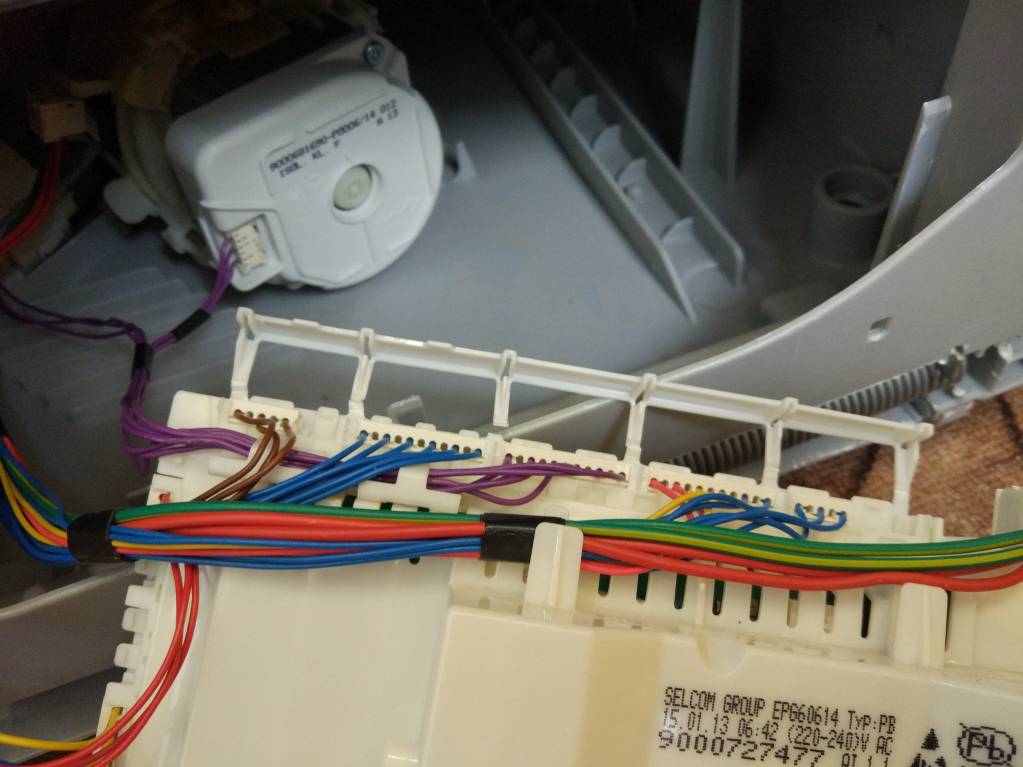

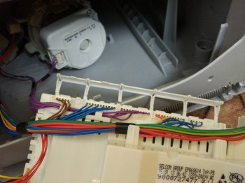

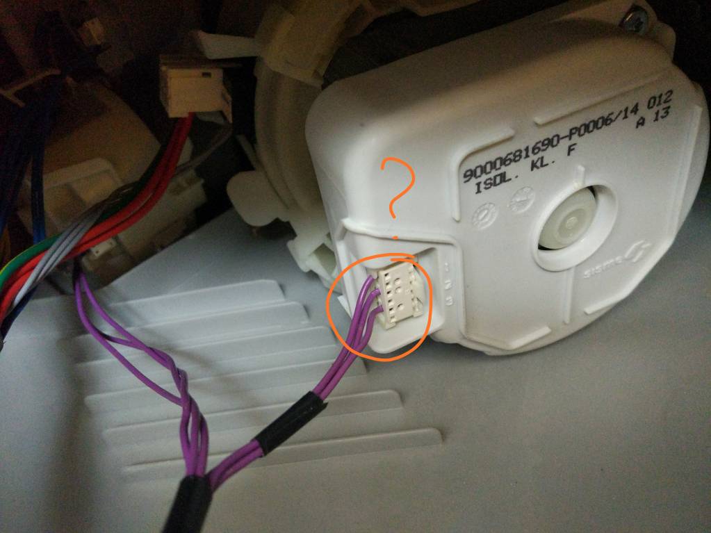

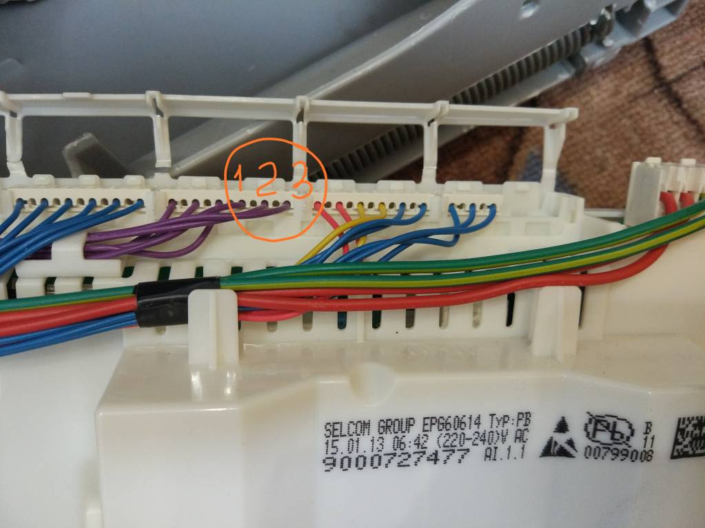

Good afternoon PMM Bosch SVM65M30RU. E15 popped out. When disassembling the PMM, I accidentally pulled out the ends from the terminal block of the circulation deposit. Please tell me where to attach them relative to the control unit, if there is such a possibility. Thanks in advance!
PS: I tore off the wires on the pump terminal block where the question mark is! On the screenshot I inserted the ends into the terminal block at random!!!

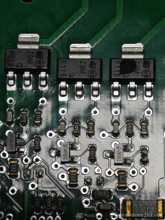

I mixed up the pump connectors... The control unit blew, it looked like the transistor and resistance were burnt out

Guest, thank you, I connected it according to your diagram, everything works :roll:
