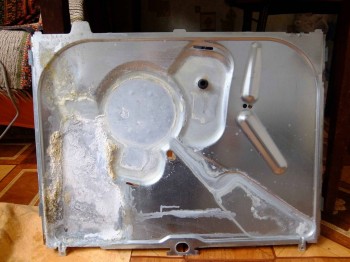

The Bosch SKS62E22RU SilencePlus dishwasher started giving error E15. At first I drained the water from the pan, tilting the car back. Then I got tired of it and dismantled the car.
The pan was heavily limed.

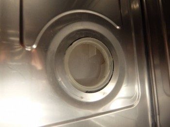

I found the leak - this is the overflow hole on the left side wall. The black sealing gasket has moved slightly to the left and down.
How to put it in place?

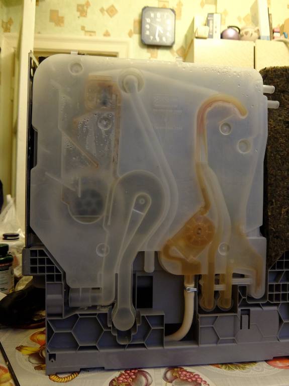

After After a long meditation on the PMM device, I found out that the plastic water fill/drain system is secured mainly only with a large plastic nut for the overflow hole.

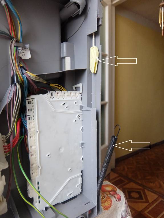

For ease of operation, I released the door counterweight spring.

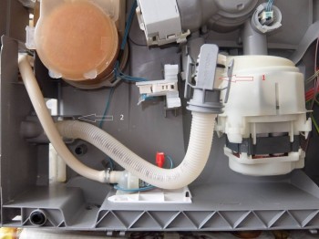

Next, just in case, I removed the water drain hose (1). I drained the remaining water from it and released it from the gray clamp at the bottom of the PMM (2).

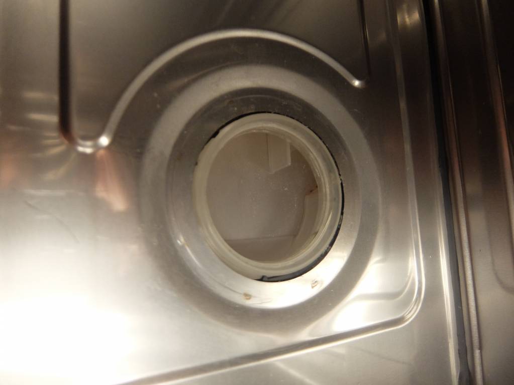

Then he carefully pulled the water fill/drain system to the left edge (according to the photo) so that his hand could fit through and removed the o-ring. I washed away the limescale deposits from it. Over 5 years of work, the ring remained soft and was not damaged anywhere.
I assembled it in reverse order.
