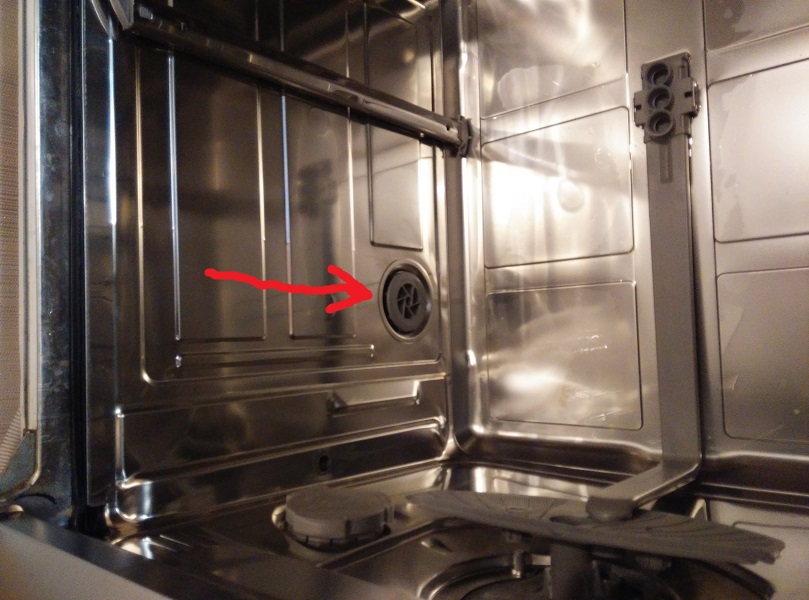

I’m understanding the PMM. I can’t get the bottom plastic tray off. The side water tank does not. The reservoir is attached to the stainless chamber from the inside with a round plastic grill (indicated by an arrow in the photo). Share your experience, friends, on how to remove this grille (unscrew it, snap it off, etc.)... It’s the only thing left...

unscrews by inserting pliers into the grill and turning counterclockwiseSaroFFsky:I’m disassembling the PMM. I can’t get the bottom plastic tray off. The side water tank does not. The reservoir is attached to the stainless chamber from the inside with a round plastic grill (indicated by an arrow in the photo). Share your experience, friends, on how to remove this grille (unscrew it, snap it off, etc.)... It’s the only thing left...
