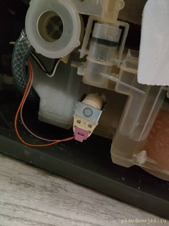

Good afternoon, question about the Schaub Lorenz dishwasher.
At one point, I filled up a whole tank of salt as expected.
At the end of the wash I decided to check the salt, but it was not there, apparently it had gone into the sewer, I noticed a strange noise from the dishwasher. It turned out that the valve in the photo was humming.
Good people, tell me what to do
Вот этот клапан сильно гудит
Impeller
 Re: Salt goes away in one wash (Schaub Lorenz 4400
Post by Impeller »
Replace the regeneration valve, right?
