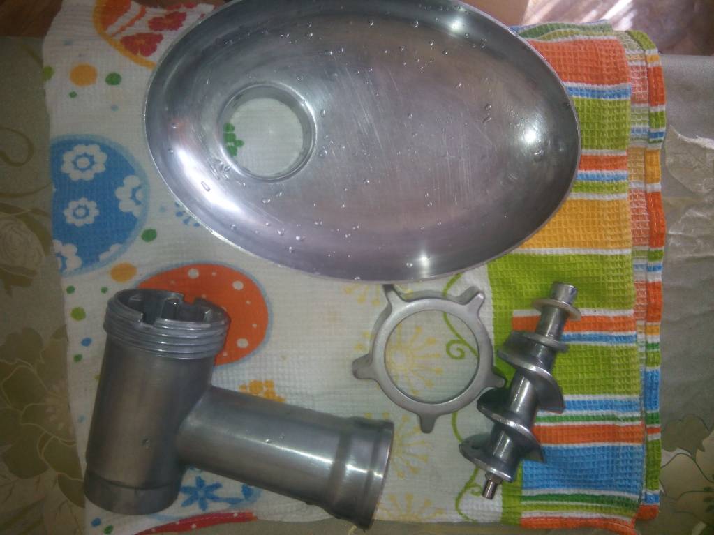

Hello everyone.
Well, I screwed up. Either it’s a girl’s memory, or senile sclerosis, or vice versa In short, I forgot that aluminum cannot be washed in the PMM. And I automatically shoved the aluminum components from the meat grinder into it. And at the exit I received them, covered with an even, dense dark gray coating, which remained well on my hands, but was difficult to wash off from the details I wiped off the tray with difficulty and was tired. And I thought that I should try to make my life easier. And then I boiled this aluminum in water with soda and washing powder (don’t laugh! In some cases it’s very effective)...
At the end I got an even smoother, even darker and denser gray coating : cry: including the previously wiped tray.
(Reference: I always had a weak C in chemistry, because the chemistry teacher never raised her hand to give a solid D.)
Question. What was it and is it possible to clean the parts of the meat grinder? External aesthetics are a secondary matter. What’s more unpleasant is that, according to all laws, this plaque will get inside people through contact with minced meat.
What did the metal react with? With powder? With rinse aid?

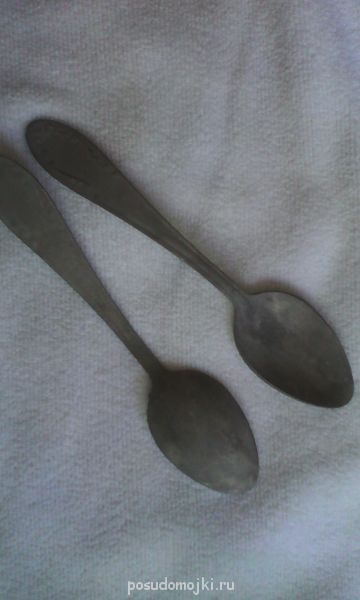

I had the same story with aluminum spoons. They turned black and smudged. But after 10-20 washes they stopped doing this. We use them.
This is what they look like now.
I had the same story with aluminum spoons. They turned black and smudged. But after 10-20 washes they stopped doing this. We use them. This is what they look like now.

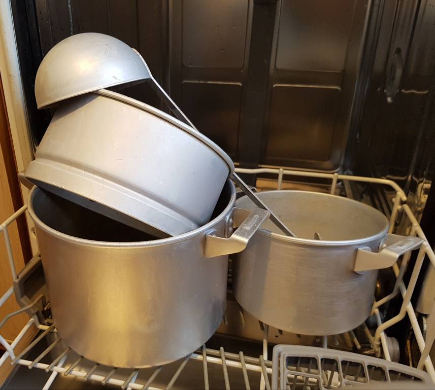

Aluminum can be washed! Just not with all products, with Finish it came out with a black coating, and then I washed it with Somat powder a couple of times - all the aluminum came out without residue, it was light and did not get dirty) In the photo there is aluminum, which I wash there all the time))
Aluminum can be washed! Just not with all products, with Finish it came out with a black coating, and then I washed it with Somat powder a couple of times - all the aluminum came out without residue, it was light and did not get dirty) :good: In the photo there is aluminum, which I wash there all the time))
I wash aluminum pans in a washing machine with Econt tablets (from Pyaterochka) or Fresh Clean from (Auchan), after the finish it gets very dark, and the main thing is to turn off the rinse aid when you wash aluminum and then the appliances will be white

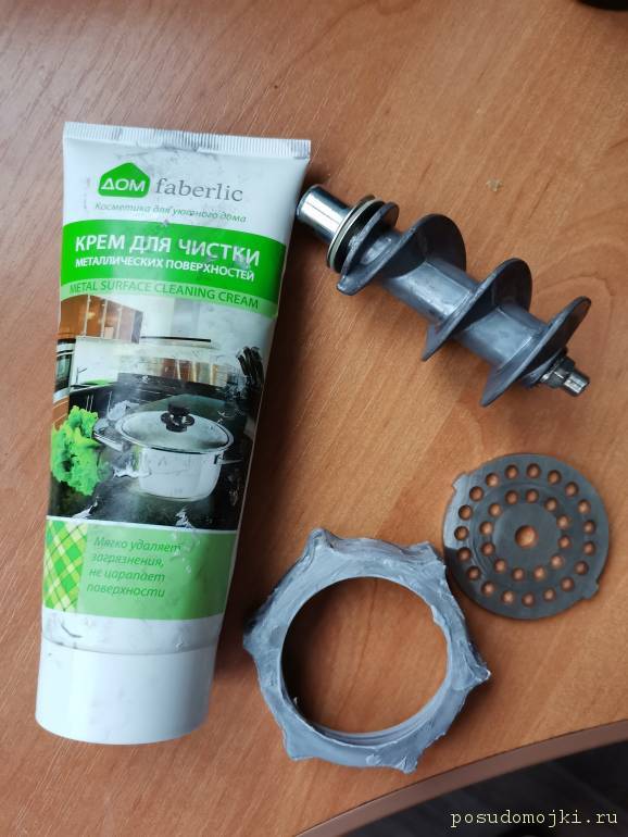

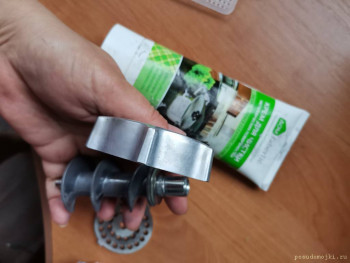

I couldn’t find Goya paste in the store, so I decided to try my cream for cleaning metal surfaces. I usually use it to clean everything chrome in the bathroom so that it shines, but here... Mother laziness + the dishwasher and the spare parts from the new meat grinder turned black . The result is not bad, the blackness has washed off, not perfect of course, I mean that if you polish it, it will be like new, but look at the photo. It turned out very well.
I think that Faberlik is quite widespread in every city, so buying this product will not be a problem
I couldn’t find Goya paste in the store, so I decided to try my cream for cleaning metal surfaces. I usually use it to clean everything chrome in the bathroom so that it shines, but here... Mother laziness + the dishwasher *x) and the spare parts from the new meat grinder turned black :sorry:. The result is not bad, the blackness has washed off, not perfect of course, I mean that if you polish it, it will be like new, but look at the photo. It turned out very well. I think that Faberlik is quite widespread in every city, so buying this product will not be a problem :)

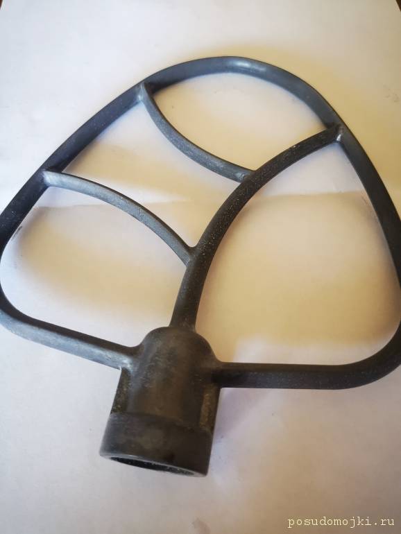

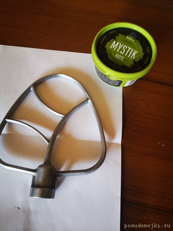

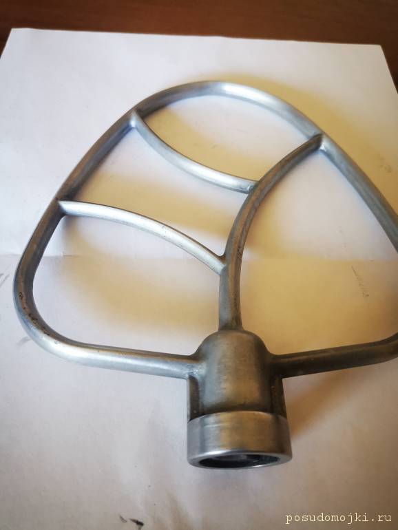

Good afternoon I washed the attachments from the planetary mixer in the dishwasher. I thought everything was screwed! But I remembered about Greenway pasta. Not perfect, but still much better. And a cloth for the vest from the same company also helped, it has one side that is shaped, but soft.
Good afternoon I washed the attachments from the planetary mixer in the dishwasher. I thought everything was screwed! *x) But I remembered about Greenway pasta. Not perfect, but still much better. And a cloth for the vest from the same company also helped, it has one side that is shaped, but soft.
