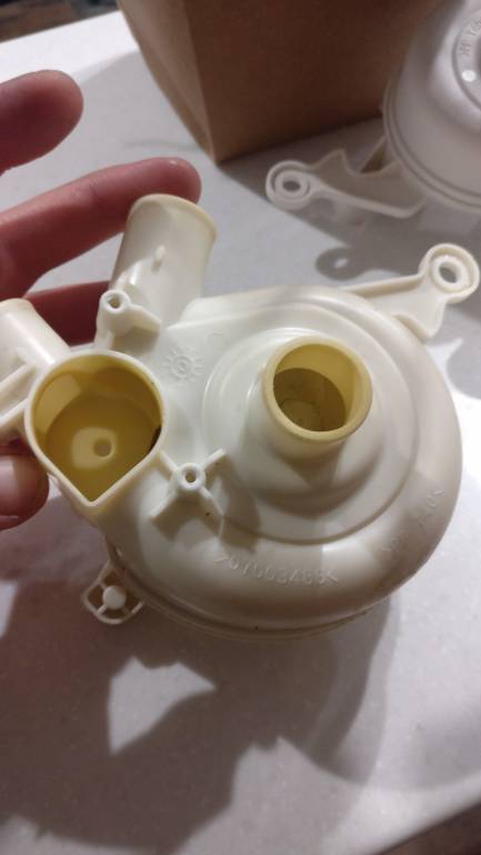

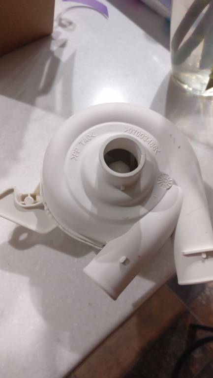

I own an Ariston exilia Li 68 DUO dishwasher. Recently I encountered a problem with water leaking from my car, after disassembling it I realized that the circulation pump volute was leaking. I ordered the snail 07003486 according to the number indicated on the removed spare part. But the trouble is, a snail of a different design arrived, but with the same number. Question, if someone has encountered such a problem, how to order, what is needed? Attaching photo

Post by Fulcrum »
The part number you need is C00088889
