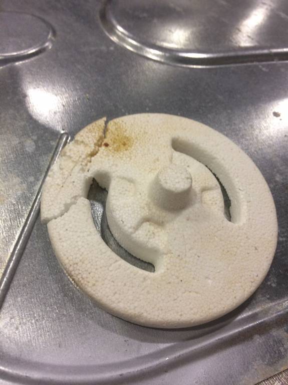

Good day. American sanctions also affected me. On occasion, I defrosted a plastic salt container in the dishwasher. I decided to save on repairs, disassembled, dismantled the tank, ordered a new one from the service center (4100 rub.!!!!!). Now I’m assembling the car. Well, actually, as usual, when collecting something that you once took apart, it’s not always clear what to put where. Next up is a foam plastic part, round, 8-10 centimeters in diameter with two slots. Tell me where it is placed??? I have two options: from below, if the machine is turned over, and in the washing area. I will be very grateful!!

Placed in a tray. The bulge presses on the aquastop sensor. There must be room in the pan for this float.

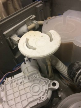

Like in photo-2?? Did I understand correctly? In general, I installed it as in photo 2. It seems to be in its place. I assembled the car and connected it. The machine started working (judging by the sounds it made). Water doesn’t flow anywhere. But! I opened it to check how it was inside, and it’s good that I opened it earlier. The water does not leave, it remains inside. Something responsible for draining the water does not work. So it goes. What to do?
