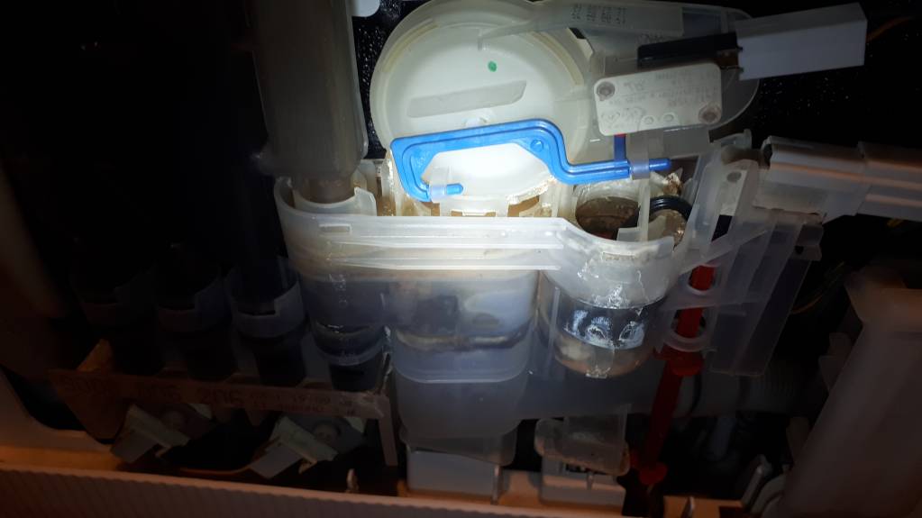

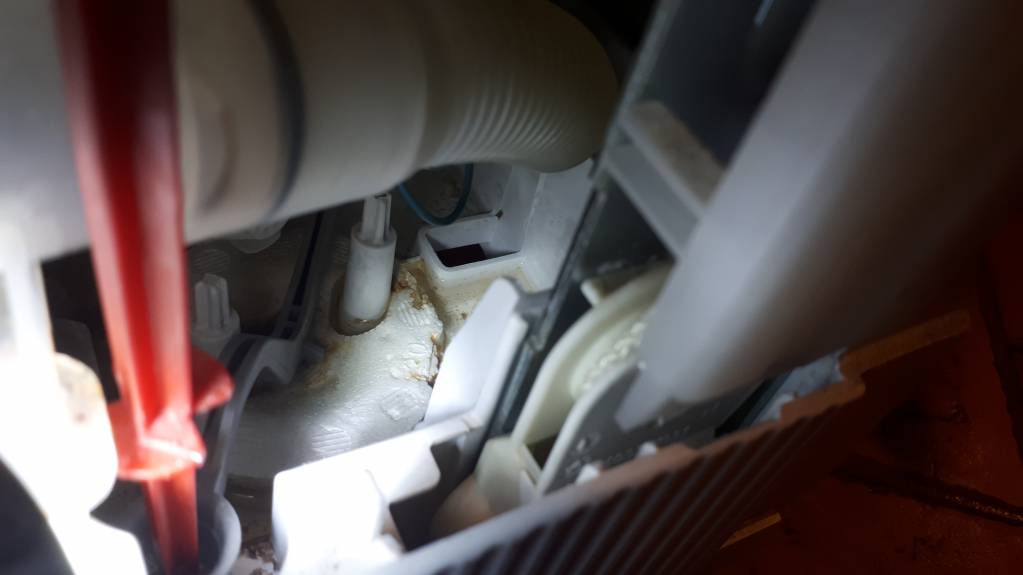

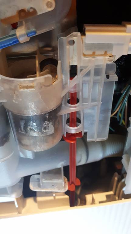

Hi all! I found a topic based on the PMM model and, in order not to create a similar one, I will continue the existing one.
So, at first I didn’t wash it until about rinsing. It was turned off by my wife on suspicion that the washing process took too long. Disabled. Looked around. Nothing but water in the pan. I did not completely remove the water with napkins. Did not help. I called a repairman at random. Nothing. But! I spied on all the manipulations.
In the end:
1. By tilting, drain water from the pan through the drainage (?) holes in the front lower part. Power is turned off.
2. Removing contacts and forced switching of power for the aquastop valve (clicks properly).
3. The PMM was started by pouring 3 liters of water into the working area. Finished the rinsing program as usual.
4. The game of battle of psychics on the topic "change brains" ended with a polite refusal and an offer to leave.
For today:
1. Twice in a quarter she refused to work, and was restored to work by following steps 1...3 (see above).
2. There is a firm belief that water is pouring into the pan, and the float in the right front lower part of the pan is blocking something.
3. There is a suspicion that water is poured into the pan at the time of filling from the water supply network. Literally, along the right (along the way) lower part there is a device (very difficult to describe, and I haven’t figured out how to post the photos yet), from which water oozes.
If someone finished reading, then let me know. I’m trying to post a photo.
