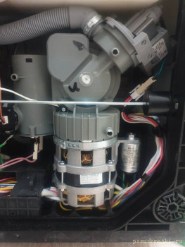

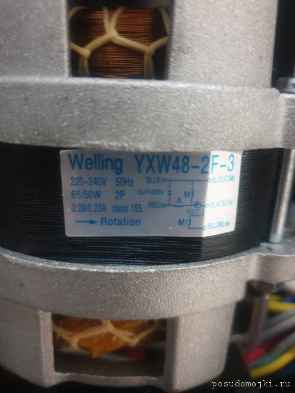

Good evening! Dishwasher flavia bl 45 camaya, the nozzles have stopped spinning, water collects at the bottom but does not splash, there are no errors, at the end of the cycle there is a signal about completion, it drains normally. What’s wrong with her, where should I go, what should I do?
Swimmer
 Re: Flavia BI 45 Alta machine, questions about the operation of Flavia dishwashers
Post by Swimmer »
Good evening! Dishwasher flavia bl 45 alta nozzles have stopped spinning, water is drawn to the required level, but does not splash, there are no errors, at the end of the cycle there is a signal about completion, it drains normally. The impeller of the circulation pump is free of foreign objects. What’s wrong with the machine, where to go, what to do?
Igor241624
Post by Igor241624 »
Same problem....
They say the motor burned out...
Getters
Post by Getters »
*x) did you solve the problem?
