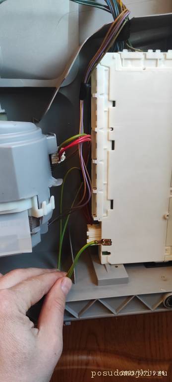

Good afternoon, car Bosch sks 60e12ru, does not drain water error e 24, looked at the bottom and saw a connector not connected, maybe that’s the problem? Tell me where it connects?
