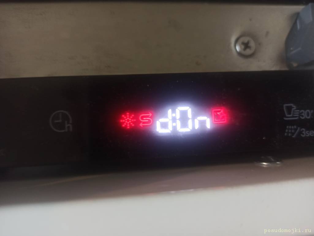

Help, what kind of error code is displayed on the PMM Medalstor Ikea display?

It looks like demo mode is on

Alternatively, try
Press the Auto Sense and ECO buttons simultaneously for 3 seconds. The display should change from d:On to d:Of
