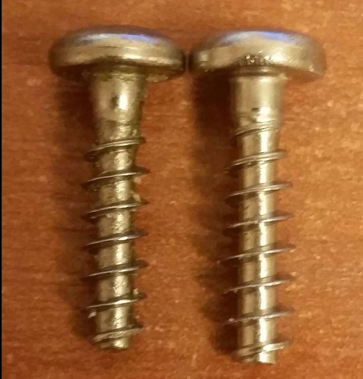

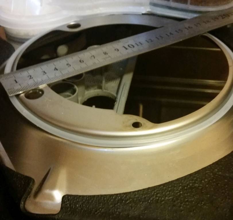

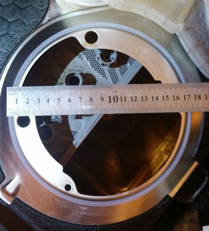

Technik79: 15 May 2017, 10:58 I want to tell everyone right away: for those who have it coming out, but manage to solve the problem by bending over or spanking - don’t flatter yourself, the problem will not go away! This error just doesn’t appear, it means your car is leaking! It can leak either through a crack in the salt container, or through leaks in the pipes, or through the joint between the tank and the filter housing from below - this is exactly the option I ended up with. This is easy to find out - remove the trim from the front underneath the door, and even better, remove the door trim - it will be better visible. You will see all sorts of machinery, hoses, etc. Turn on the machine, take a flashlight, a pillow, lie down and wait to see where the leak will come from (it will not leak right away, be patient). Further - depending on the circumstances. If it flows at the junction of the tank and the filter housing, buy a repair kit BS 12005744, and install it - half an hour of work
It seems that this is the only mention in this thread of the official repair kit from Bosch , which should treat the “marriage” they have started. I bought it today, maybe this information will be useful to someone in the future.
The gasket in the repair kit 12005744 is hollow, i.e. This is not just a silicone gasket, but a glued tube. The self-tapping screws are only slightly larger than the original ones. According to my measurements, it will turn out something like this: original - 18.4 mm 2.1/3.8 mm, repair kit - 19.0 2.2/4.1 mm, i.e. those who use 4.5 mm screws instead of the original ones may be going too far.
