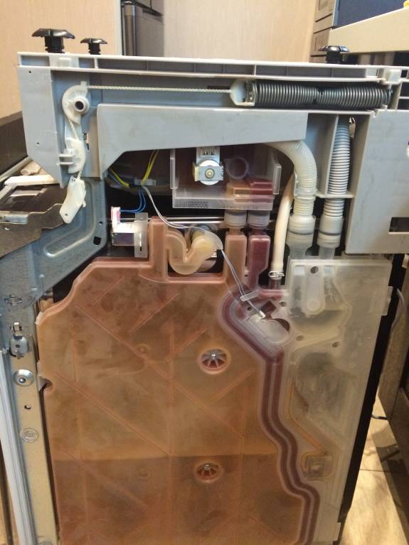

7. Leak between pump and steel tank. (you open the door and at the bottom you see plastic bells and whistles, but at the junction with the metal it can leak.
8. Somewhere the hose inside the car is cutting.
Well, that’s actually all that I have determined for myself.
Next, I watched several videos about eliminating the E15 error, the only thing that helped me there were several videos of a certain very smart comrade in a red overall.
The comrade is really very smart, but because he really wants to share with his incredible knowledge in the field of PMM, he begins his opuses with the fact that when the earth was cold... then birds appeared.. in general, I didn’t watch a single video of his to the end because I was inevitably carried away to Morpheus. I even thought of putting Bookmark his video in case of insomnia, it really helps.
So what am I talking about?! Ah! yes!!, so after all of the above, it was time to board the anti-aircraft missile.

6. Under the door, there is a metal casing, it is attached with only 2 screws, we unscrew it and remove it.
In front of you are all the components and assemblies, we carry out a visual inspection for smudges and leaks. (perhaps everything will become clear to you by now). In my case, I didn’t have enough visibility and had to remove the side metal covers. They are attached to the ears and on one screw, but to get to the screw you need to remove the small casing that covers the cord from the door closer,
Here it is: Fig1
It is attached to clips, just carefully pry it off with a screwdriver.
Next, unscrew the screw, remove the metal casing, and do the same on the other side.
Next we remove the sound insulation, and voila!! You can view ALL components and assemblies!
Fig2

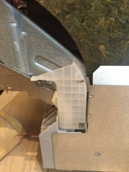

Next I did so, turned on the PPM and started it for a quick wash.
Having acquired a flashlight, I lay down at the PPM in wait-and-see mode “where the radio is.”

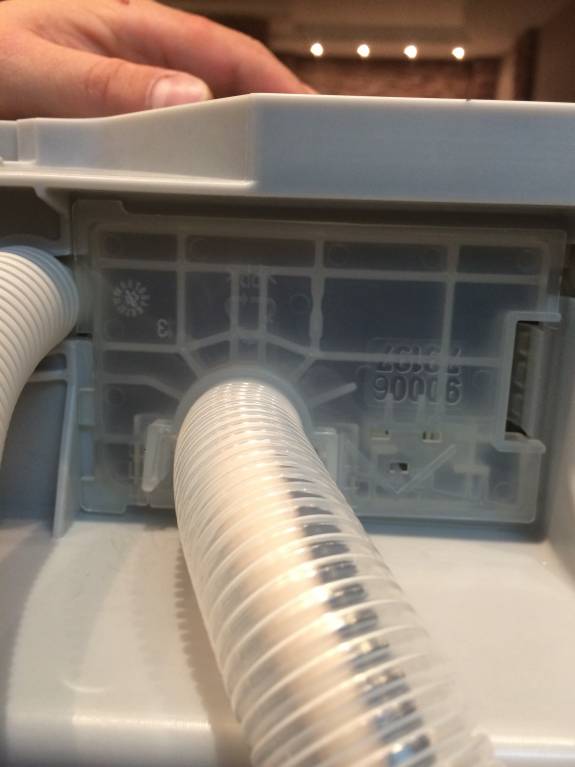

Well, what can I say, whoever searches will always find, in intensive mode washing with the maximum water temperature in the machine, I saw this Manneken Pis!!!
As it turned out, the rubber seal between the tank and the pump (we’ll call it that) was etched.
Fig3

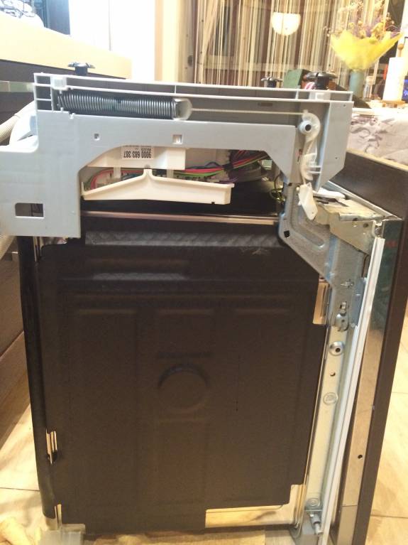

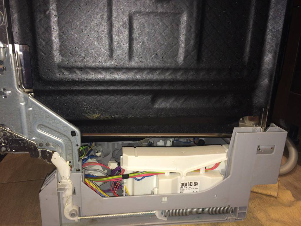

4. The side covers and sound insulation were still removed in the previous act. We turn the car over (I turned it over the right side, if you were facing it).
We turn it over carefully, without sudden movements, to the sounds of gurgling PMM.
Fig4 Fig5
5. We remove the door closers. We pry up the spring and pull it towards ourselves, pulling out the entire mechanism. Because I used to often have extra parts left after assembling, or during assembly I didn’t understand how it was, I advise you to take a photograph of it before each removal of anything, it inspires peace of mind and will I be able to assemble it later!)
Similar Operation We also carry out on the other side.
Here it is: Fig1
Fig2
Fig3
Fig4 Fig5
